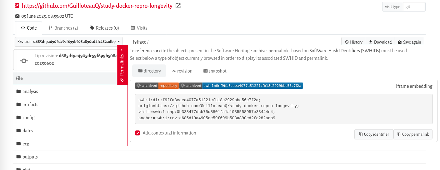

An easy way that we can save our repository on Software-Heritage through their web inteface: Save Code Now
After the snapshop will be taken, we will be able to access it and retrive the permalink (on the small red tab on the right side of the screen).
This is what the permalink for sharing a snapshot of a repository on Software-Heritage looks like:
https://archive.softwareheritage.org/swh:1:dir:f9ffa3caea4077a51221cfb18c2929bbc56c7f2a;origin=https://github.com/GuilloteauQ/study-docker-repro-longevity;visit=swh:1:snp:0b338477dcb75d8801fa1a1035558957e33444e4;anchor=swh:1:rev:d685d19a4905dc59f699b508a890cd2fc282adb9

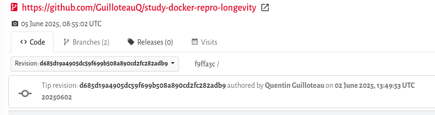

Explore the repository!
As we can see, there are all the information: URL of the repository, commit authors, commit time, branches, ect. Those are all the information we would like to remove.

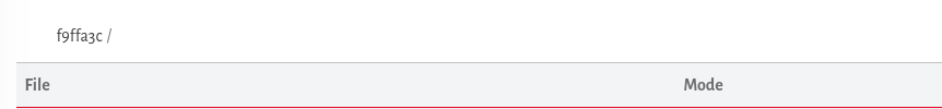

To anonymize, simply remove the everything but the first part of the URL, and you get
There is nothing more than the code now: no commit information or link to the repository. But still, someone can explore the code in the snapshot.

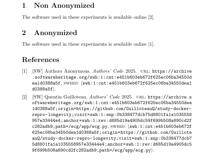

In the .tex we can then cite/reference our code with the \cite macro:
The software used in these experiments is available online~\cite{myrepo}.
For the anonymize version, we just need to remove the sensitive information from the swhid and url fields:

The snippet above will generate the following:
result
