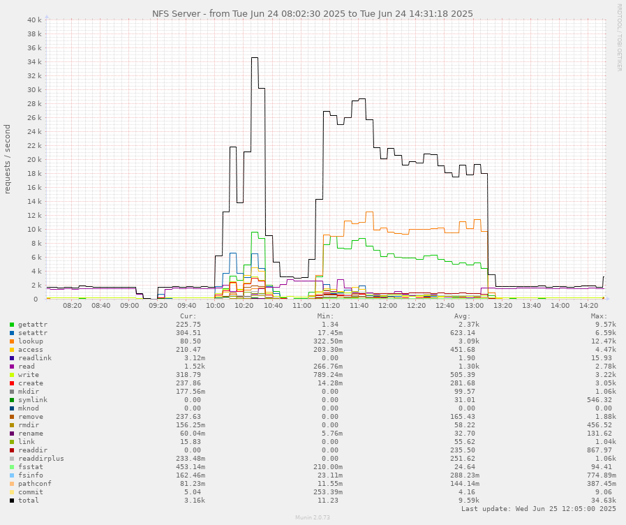

As this was also the first edition with that many participants, we were also fearing some technical issues, namely the performance of the NFS servers of Grid'5000. This is because, as Nix is not installed and supported by default on Grid'5000, we have asked the participants to install Nix in their /home/ directory, which are stored on a NFS server. When evaluating and building, Nix will make a lot of system calls which could greatly impact the performance of any file system, but is even worse on NFS. (more information can be found in the very good Guix blog post). Howerver, it seems that the NFS servers of Grid'5000 survived, but the tutorial did stress it.
Below is the requests per second on the NFS server of the Grenoble site of Grid'5000. The tutorial took place between 9:00am to 12:45pm, with a break from 10:30am to 11:00am.
Usage of the NFS server of the Grenoble Grid'5000 site during the tutorial
We can indeed see the high loads in getattr and lookup system calls, which is what we expect from a Nix usage.
